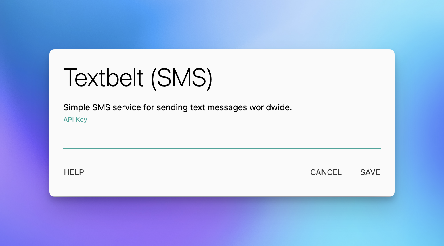

Step 2: Add Textbelt to SharpTools
- Navigate to your User Page in SharpTools
- Click the Manage Connections button
- Select Textbelt (SMS) from the list of available platforms
- In the dialog that appears:
  - Paste your Textbelt API key
- Click Save to store your credentials

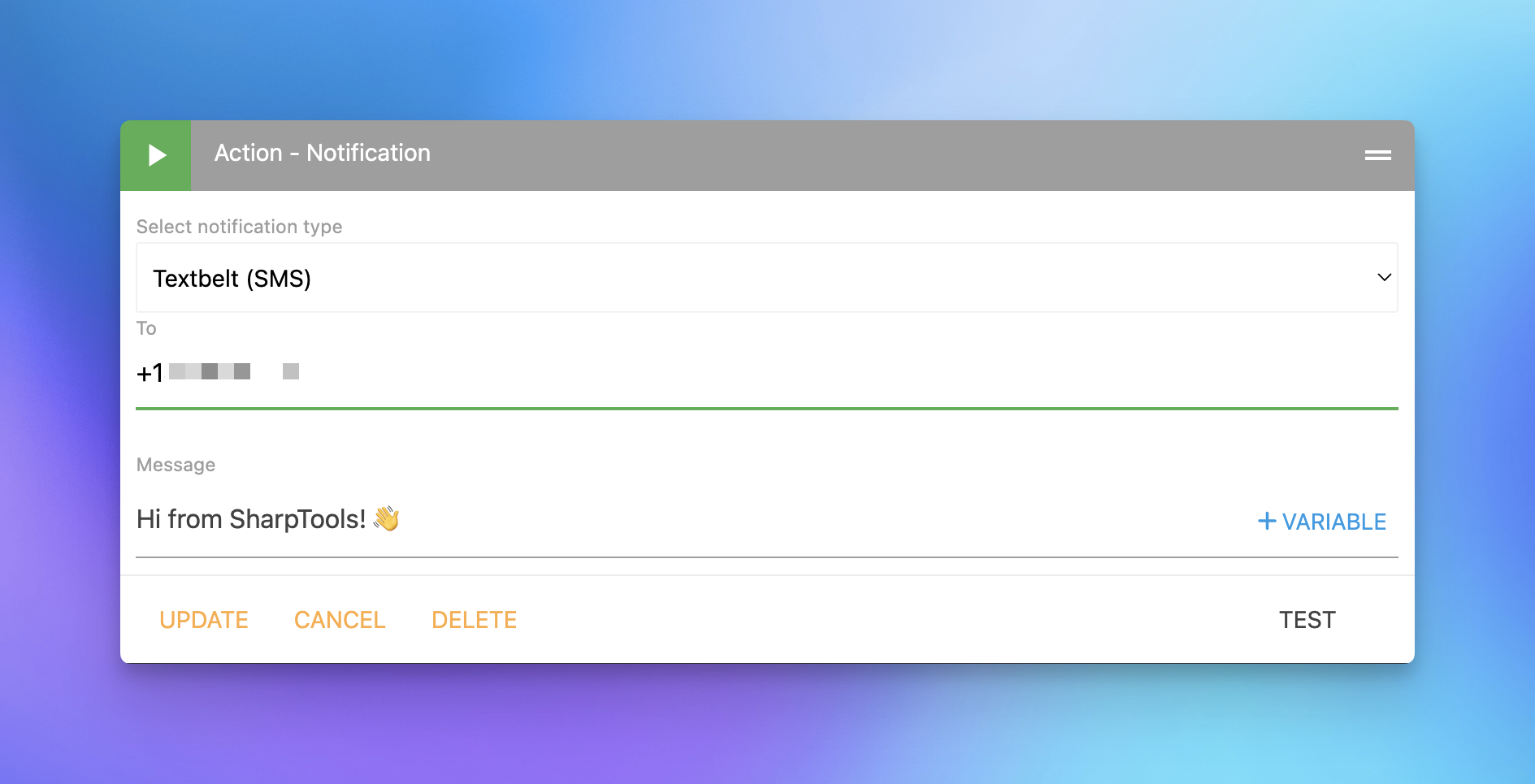

Creating a Textbelt Notification Action
- Open the Rule Engine and create or edit a rule
- In the Flow section, add an Action
- Select Notification as the action type
- Choose Textbelt (SMS) from the notification type dropdown
- Configure your message:
  - To: Enter the recipient's phone number
    - US/Canada: 10-digit number (e.g., 5551234567)
- International: Use E.164 format with country code (e.g., +44207183...)
- Message: Enter your message text (up to 160 characters per Textbelt credit)

Testing Your Configuration
Before saving your rule, you can test your Textbelt setup:
- After configuring the notification action, look for the Test button in the action footer
- Click Test to send the message
- You'll see your remaining SMS quota after the test message is sent
