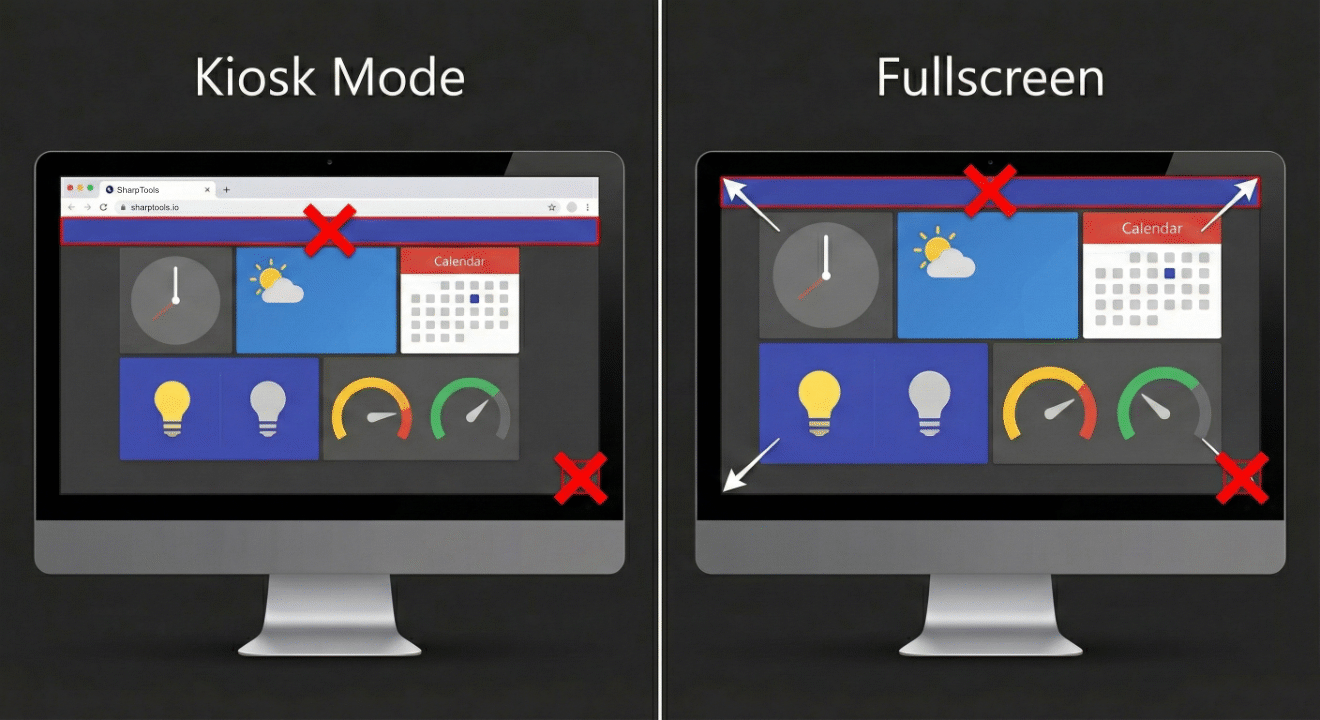

Fullscreen vs Kiosk
While these methods seem very similar at first glance, there are some differences between them. When you tap the Fullscreen button in the ...   menu it tells SharpTools to enter kiosk mode and tells your browser to go fullscreen.  What's the difference between these two things you might ask?
  • Browser Fullscreen: hides the browser navigation buttons / URL input and makes the browser fill the screen.
    This is most noticeable on a desktop or laptop as the browser filling up the whole screen is significant visual change. On mobile devices, this is less noticeable and when you tap the [ ]   fullscreen button you're likely noticing SharpTools going into kiosk mode
  • SharpTools Kiosk (fullscreen): hides the navigational elements in SharpTools including the top navigation bar and the `...` in the bottom-right corner
The primary thing that most people are looking for is to hide the SharpTools navigation elements, which can be accomplished by either tapping the Fullscreen button or adding `?kiosk=true` to the end of a dashboard URL.
One of the key differences is that when you tap the Fullscreen button, it tells the browser and SharpTools to hide the navigational elements, but if you exit out of fullscreen in your browser or the browser page reloads, then SharpTools will also exit out of kiosk mode.
When you use the ?kiosk=true parameter, anytime your browser opens that page it will automatically put SharpTools into Kiosk Mode which will hide the navigational elements. Even if the browser page reloads -- for example you're using an app like 'Fully Kiosk Browser' which can autoreload or recover from a crash, then the URL parameter will automatically put your dashboard back into kiosk mode and hide the navigational elements.
