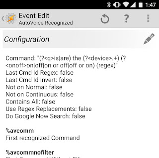

For example, if we wanted to setup a profile that allowed us to ask 'Is the [device] on?', we could change the voice query from above to use AutoVoice's RegEx feature to allow us to dynamically ask if a device is on using a query like:
  • AutoVoice Filter: (?<q>Is|Are) the (?<device>.+?) (?<onoff>on|off|on or off|off or on)
    Note: Make sure the "Use RegEx" box is checked in AutoVoice when using this approach -- this will convert the funky groups in parenthesis to variables that get captured.
